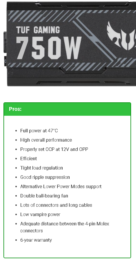

As long as the psu gets good airflow, installing it with the fan facing down is ok.
Maximum operating temperature isn't listed in the tech specs, but as with most psu's, up to 50c should be fine.
