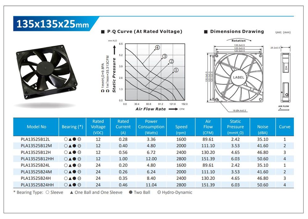

I've found the specification for the original fan (Model: PLA13525B12M - shown in the screenshot below (curve 2) ).

The best candidate for replacement in my opinion, is the Noctua NF-A14 IndustrialPPC 2000 (3-pin). It's 12V, meets the curve of the original fan, and has pretty much the same airflow and better static pressure. Its minimum voltage seems to be 4.95V and it's running stable at 5V. I shouldn't have any problems at 5V and runs quieter at low rpm.
