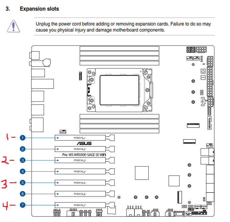

I built PC with motherboard PRO WS WRX80E- SAGE SE WIFI and CPU AMD Ryzen Threadripper PRO 5955WX. I only can start 3 Graphic card Gigabyte 4090 on this main together Ubuntu , I see in manual it can support 4 x pcie x16 on 4-way configuration. but I don't know how to config. Anyone can help me ?
3,748 Views
13 REPLIES 13
az0966
Level 8
I saw this one in manual of the motherboard
Nate152
Moderator
Hello az0966
Makes sure you have enough power for 4 gpu's.
I imagine you're using a threadripper cpu which should have plenty of pcie lanes for 4 Nvidia gpu's.
With 4 gpu's, they would go in the 1,3,5,7 slots, you may lose connectivity with the headers below the number 7 slot.

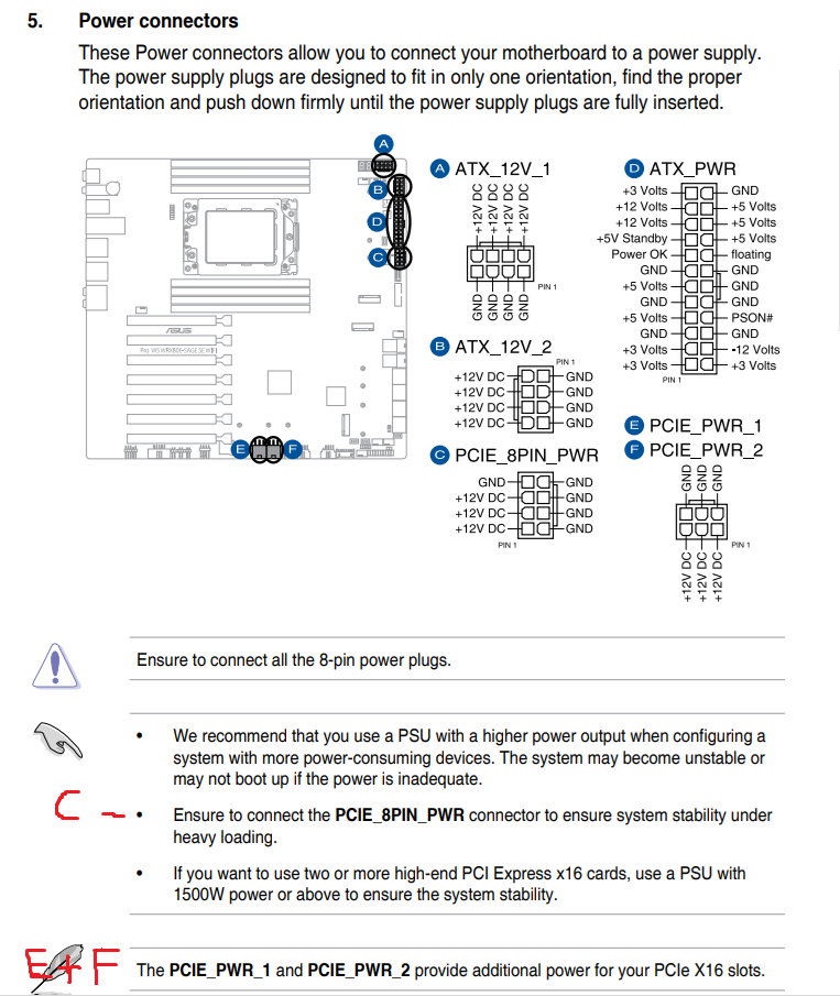

az0966
Level 8
Hi Nate152,
I have 2 PSU 1650W and 1550W to supply for the motherboard + 4 GPU. I only start Ubuntu with GPU connected to the 1, 3, and 5 slots, when I connect the 4th card to slot number 7, the Ubuntu can not start. I need connect the power to this port or not?
Nate152
Moderator
When using more than two gpu's, it's a good idea to connect a 6-pin pcie power cable to E and F.
You can also connect an 8-pin pcie power cable to C.
az0966
Level 8
Ok, let me try, thanks in advance
az0966
Level 8
I changed some items in BIOS and it worked.
Thanks
