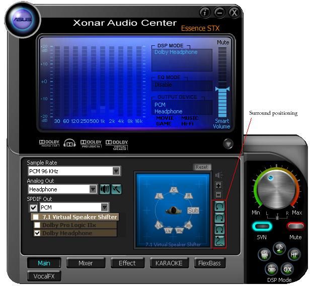

how can u say it is the same Dolby Headphone ? cant even adjust the speaker positioning anymore ! if it is the Dolby headphone, why they need to bring such stupid option like Xear surround Headphone !???
WTC
What do you mean by "adjust speaker positioning"? Is it a feature of Dolby Headphone or you're talking about something else?
appsmarsterx
yes .. it is an option in Dolby Headphone
17543
WTC
That's called 7.1 Virtual Speaker Shifter, as being highlighted in the menu to the left. It's not part of Dolby Headphone. You'll get the effect with both 7.1 Virtual Speaker Shifter and Dolby Headphone turned on because 7.1 VSS will process the audio stream before DH.
Dolby PCEEv4 is the new version that combines Dolby Headphon, Dolby Virtual Speaker, and other stuff like ProLogic IIx maybe. I would imagine combining that with 7.1 VSS will create conflicts.
appsmarsterx
ohh my bad I thought Speaker Shifter is part of the Dolby Headphone.
