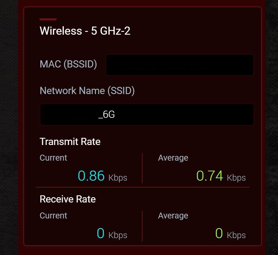

My system is set to use Ethernet Back Haul only and I see no mention of the 6 GHz SSID, except in the section shown below. The info shown is confusing but the actual radio for that SSID is not available to my AX92U or 68U..
89403
