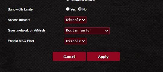

This looks interesting but it is on an AXE16000. If you change it to include the AiMesh nodes, does it make it work?
94652
Maximus Z790 Hero,
Intel i9-13900k
Intel AX411
94652

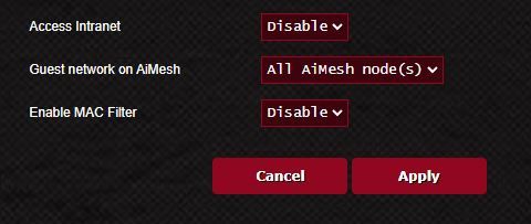

No, unfortunately that does not work. In the GT-AX11000 router admin UI, that option is "ALL AiMesh Node(s)" (see image below), and it's set to that option for the Guest Network. But it doesn't seem to make any difference.

I created guest networks on all 3 bands (2.4Ghz, 5Ghz-1, and 5Ghz-2), none of them allow devices to connect via node. I also tried all 3 guest networks in each band, but only the first guest network in each band has the option to extend the network to "All AiMesh Node(s)".
