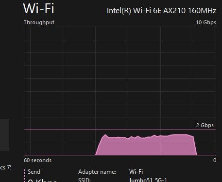

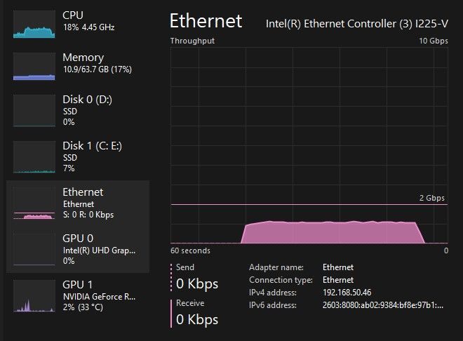

There is no way for us to know if your router has some particular problem. Below is an attachment of my transferring a 4 GB .wim file using Wireless (2402 Mbps) to the Router and a 2.5 GB link to my system.
I suppose we can't rule out the ASUS dongle being involved. The only type of test I can do it using different types large files to test the transfer rate.
And you do have plenty of room on the drive to which you are copying the file?

After my last test, I no longer need to check my system. With the speed I see here, going from Ethernet 2.5 Gbps to a Wi-Fi on the 5 GHz network, I got the transfer speed below. I don't know what was going on yesterday but this looks much better.
