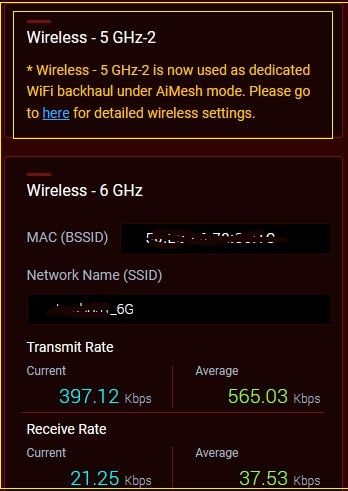

If you are using AiMesh nodes, you have to be careful and make sure the 6 GHz radio is not being used for the Backhaul. You also have to be careful because you might be able to see the 6 GHz network through the mesh node and not an actual 6 GHz signal.

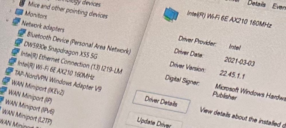

its definately a Intel AX2210 card

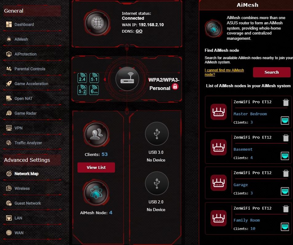

Also, every AImesh unit is hard wired to the ET12's WAN on the 2.5gb port ethernet connected to a 10gb switch on its 2.5gb port and the ASUS AXE16000 router is set to "Ethernet Backhaul mode" turned on

You can try to force them to backhaul on 6 GHz to check if they are working, (if they are close enough to each other)...

If you are running a recent version of Windows 11, you do not need the older Wi-Fi driver. I am using that driver for a Windows 10 system I have and it works fine.

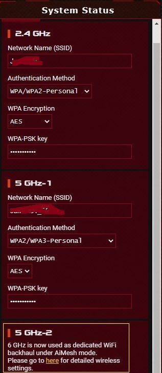

I do show the two comments below, first from the Network Map section and the second from the AiMesh section, which seem to disagree.

I agree with @Saltgrass, the third image shows a Driver dated 2021-03-03. *Hopefully you can update it and report?

It was latest driver..
i was on windows 10 and tried everything to get 6ghz to work,, including using old driver.
nothing worked.. so i upgraded to windows 11 (yuck btw) and installed the latest intel drivers, still nothing, so i read on an intel community post someone was having same problem while on win11 so i uninstalled and tried old driver (probably meant for win10) to see if it worked.. it did not and then i posted the pic here.
im updating them again.

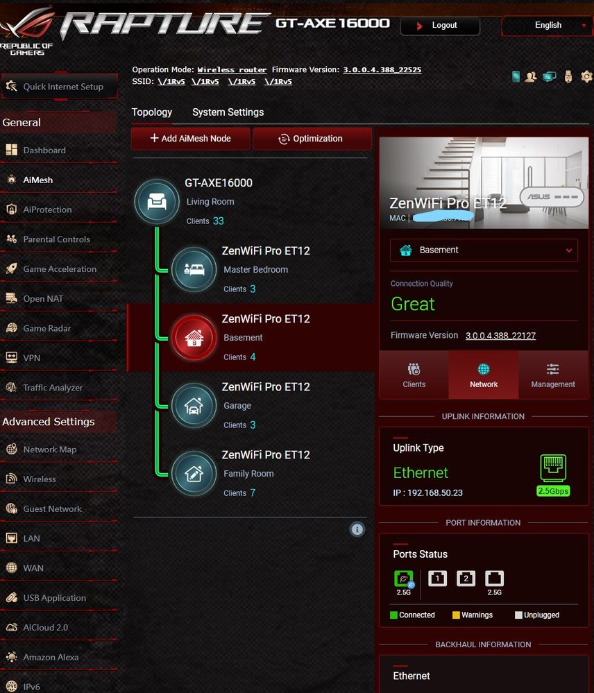

i will try to factory default router and disconnect it from all except wifi 6ghz and modem and see what happens
it should be noted in case anyone see's im on my isp's modem/router combo 8gb connection, that will not allow bridge mode, so i have the asus axe16000 in DMZ which is why the odd internal ip
heres a pic of my network map which also correctly shows wired backhaul
97648
