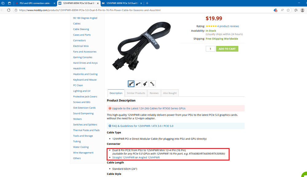

You could however just get a 2x8-pin to 16-pin cable, this one is compatible with the ROG Thor.
12VHPWR 600W PCIe 5.0 Dual 8 Pin to 16 Pin Power Cable for Seasonic and Asus - MODDIY
16 pin is enough instead of 24 ?
Nate152
Moderator
Yes, the 2 x 8-pin to 16-pin cable supports up to an RTX 4090.
