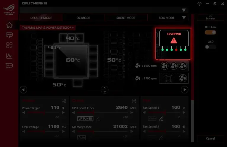

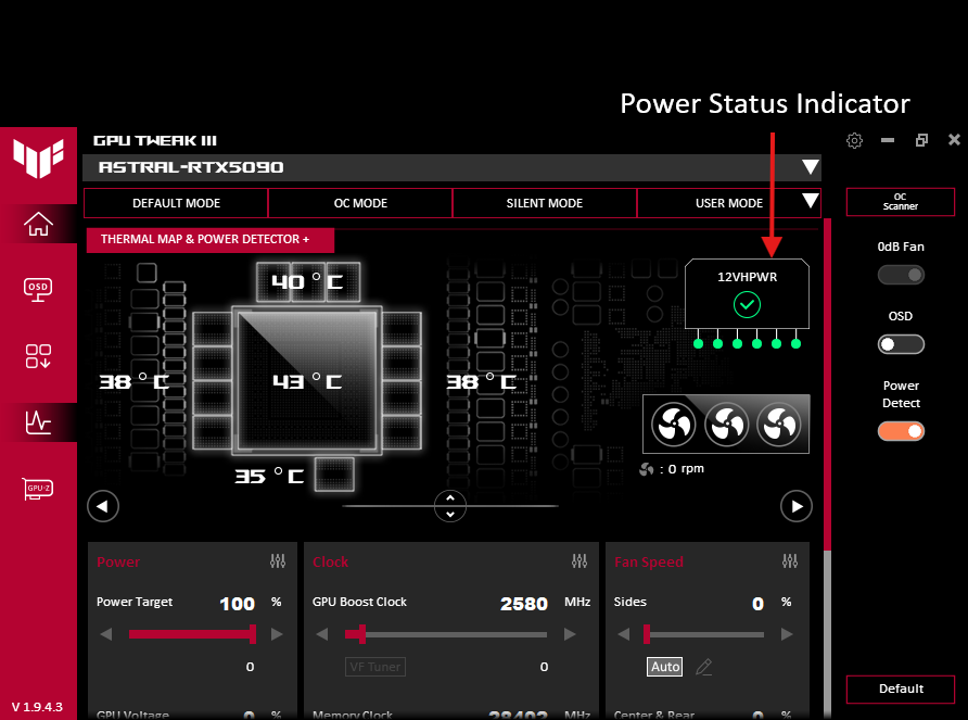

Again, the adapter should be used when there isn't a native 16-pin. Ensure the 16-pin connector is fully seated at both the PSU and GPU ends and game away.
Remeber, you can use the Power Detector + feature to monitor amperage across all 6-pins. It can also be used to notify you of any issues.
The indicator will change to red when a pin exceeds one of the thresholds.

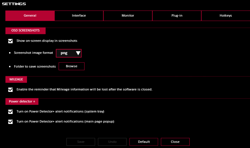

Enabling System Alerts:
A pop-up or system tray notification with an audible alert can be toggled from the General tab.
