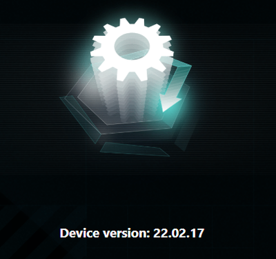

Unfortunately, the bundled cable was not working out of the box and as i had waited very long (about 2 weeks) for it to arrive, i didnt wanted to wait for a replacement just because of the cable, so i was using the samsung cable i had with me. And it was working really fine for the whole year without any problems, now it is not even getting detected when connected by cable, only when connected by 2.4g and bluetooth its showing up. Here is the screenshot of the firmware versions.
Please help me with this issue.

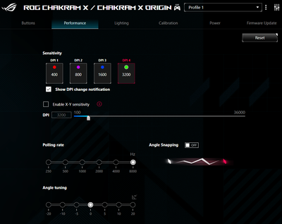

Here is a screenshot when dongle is connected but the mouse is on wired mode connected to pc.
And here is screenshot where mouse is still on wired mode connected by a type c cable, but dongle has been removed from the usb port.
As you can see the device is not even getting detected.
