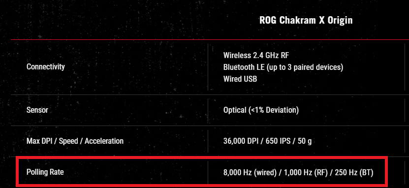

based on your question, the polling rate of 8000 Hz is only supported in wired mode.
You can refer to the table below for details.
If you are currently using the wired mode but unable to achieve 8000 Hz, please provide us with the settings screen where you cannot reach 8000 Hz.
