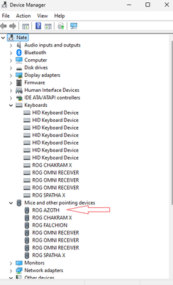

3) In wired mode, your ROG Azoth should show in device manager under "Mice and other pointing devices", does your ROG Azoth show in device manager?
3 weeks ago
1) No. (I tried both connected and dis-connected).
2) No
3) No, it's is not recognizable by any of the systems.
