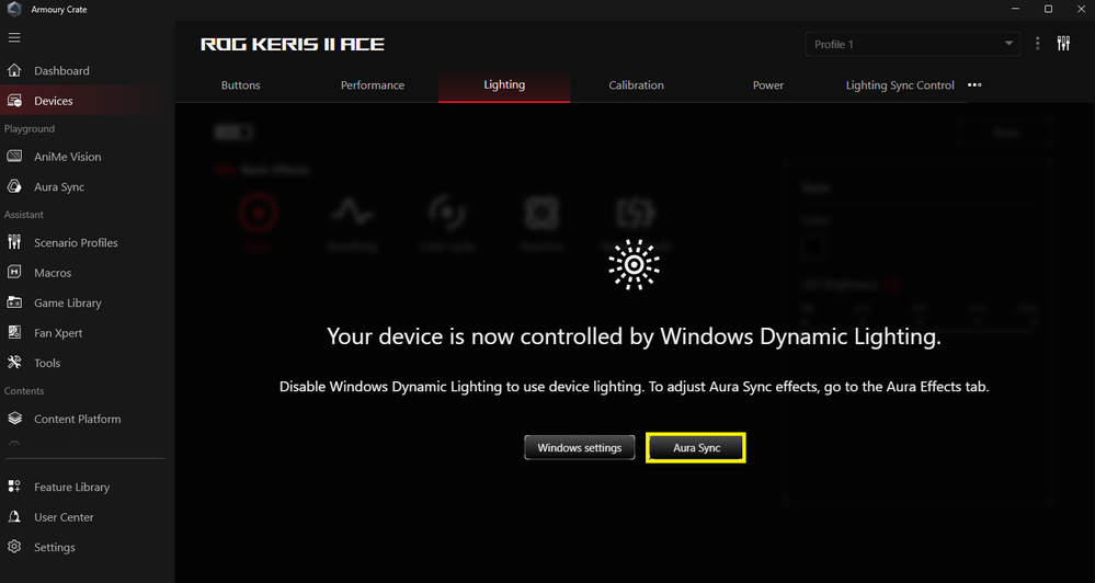

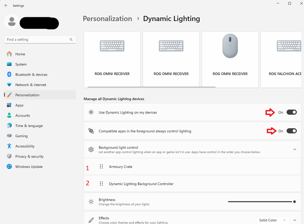

1) Make sure windows dynamic lighting is turned on and Armoury Crate is at the top of the Background light control list.

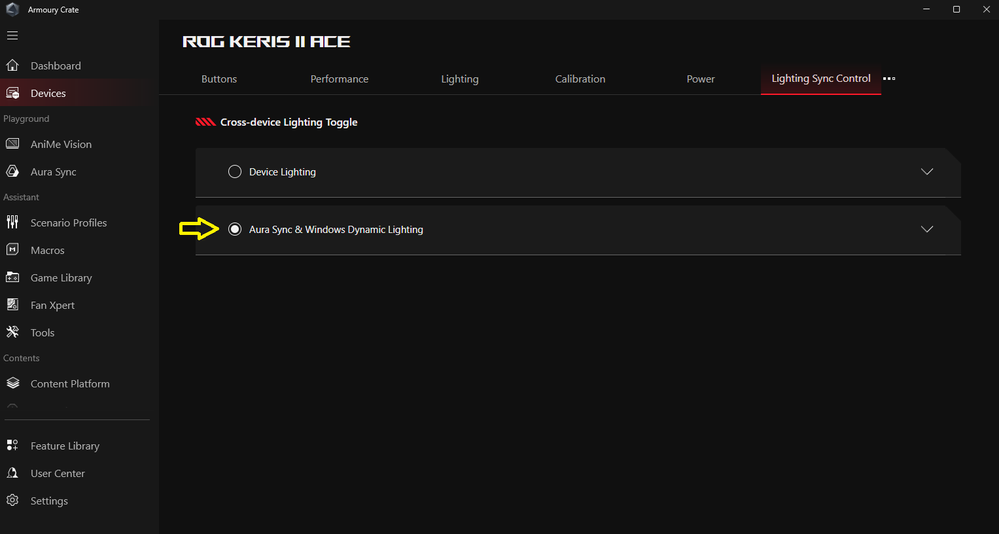

2) In Armoury Crate on the Devices tab, select your ROG Keris II Ace. At the top, click Lighting Sync Control. Tick Aura Sync and Windows Dynamic Lighting.
3) On the Lighting tab, select Aura Sync.

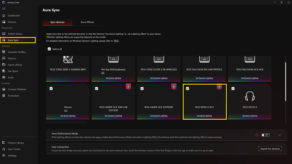

4) On the left, select Aura Sync and check the box for your ROG Keris II Ace.
