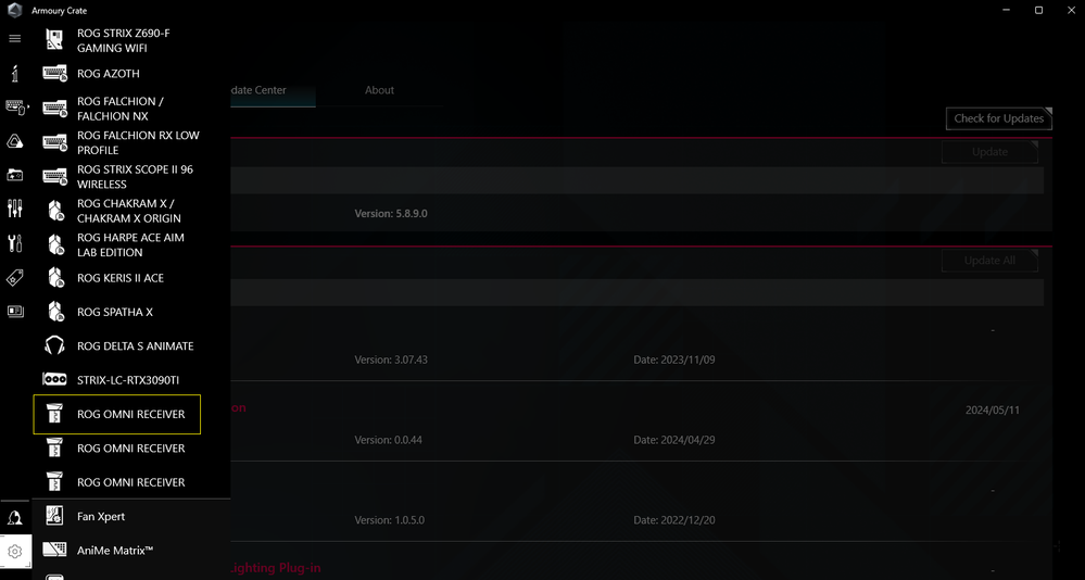

Once installed, the ROG Omni Receiver should show in the Device list.

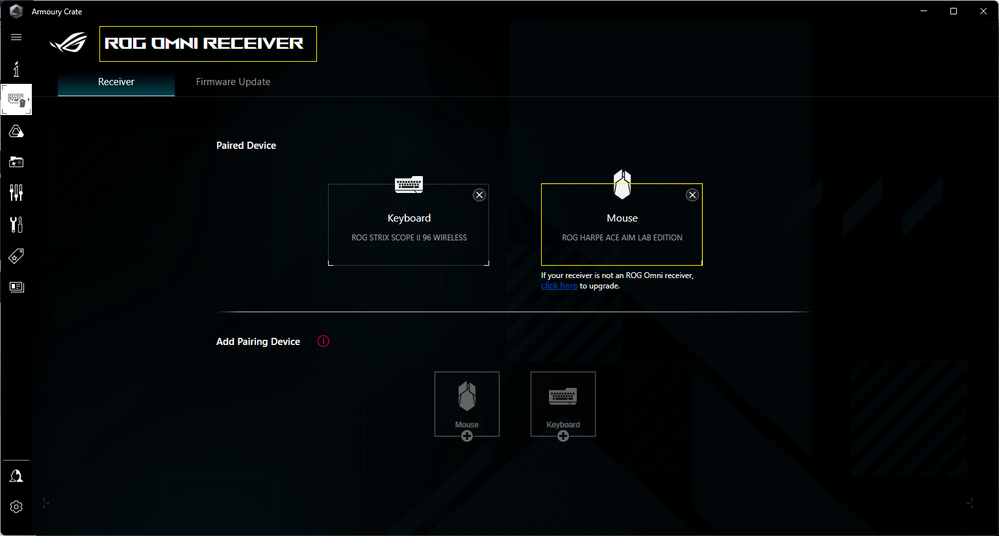

Click on the ROG Omni Receiver and you should see this.
