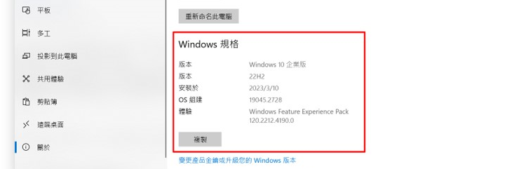

I apologize for not explaining clearly.
Regarding the Windows information, could you please PM me with the information as shown in the images below?
