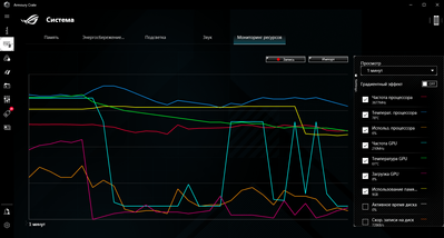

Hello everyone, I am the owner of an Asus Flow X13 laptop and an XG Mobile external GPU with a 3080 graphics card. I've been dealing with a problem that has persisted for quite some time now. Previously, I occasionally encountered the following issue: while playing games installed on external drives, they would freeze for a few seconds, and during these moments, in the Armoury Crate program, I would see the GPU load and usage (purple and blue lines), as well as the CPU usage (orange), drop to zero (I will attach a screenshot). I was able to indirectly fix this problem by moving all the games to the main drive.

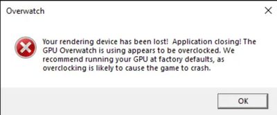

On top of that, Overwatch started crashing and showing an error (I will attach a screenshot) stating that the "GPU appears to be overclocked." The problem is that even when I set the Turbo mode in Armoury Crate, it's not enough, let alone other modes. So, I started using the manual mode, where I set everything to the maximum - base clock offset 200/200 MHz, memory clock offset 300/300 MHz, SPL 45/45W, SPPT 80/80 WT, and maximum fan speed. But the game still crashes. Dead By Daylight also crashes, and gives the error message that says "Fatal error: [File: Unknown] [Line: 198] Unreal Engine is exiting due to D3D device being lost. (Error: 0x887A0006 - 'HUNG')."

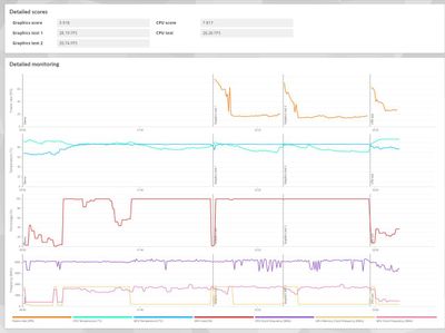

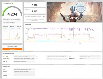

As I have mentioned, I have already tried to update all drivers, many times, but issue still persists. In my opinion,  the thing is, that all drivers I'm trying to update are for my laptop, but problem hides into xg mobile, and for it, all I was able to found is an advice to flash Vbios, but I suggested it is an risky and finicky operation, so trying it on my own could brick my device. And I also tried Myasus, every possible system check - nothing found, everything is fine. Also, I decided to run a performance test in 3Dmark, and got devastating results - performance it thrice as low as it is supposed to be with my hardware, thus complementing the fact, that something is wrong, screenshots attached, kindly look.
