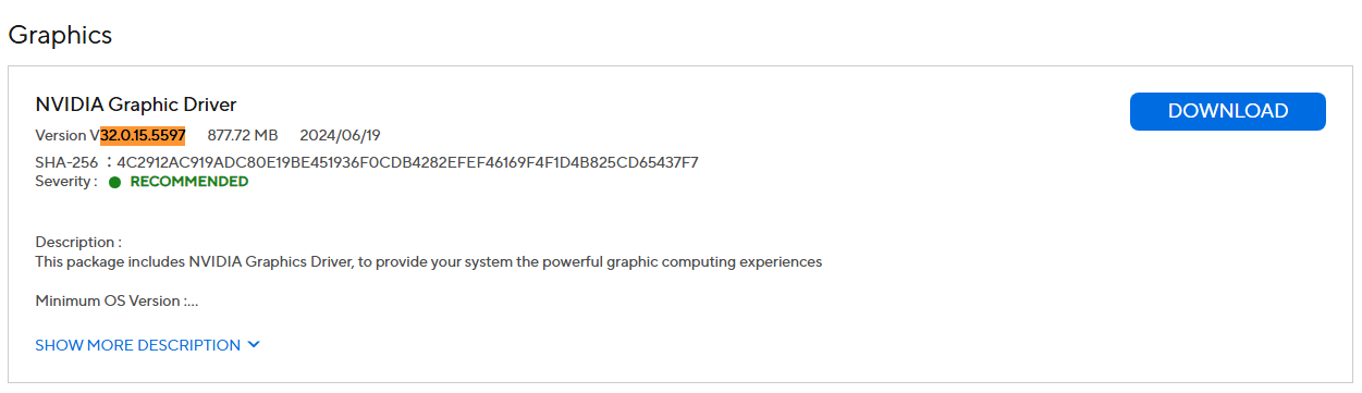

Hi Falcon, sorry for the late reply. I checked my records and found that I installed the graphics driver from the asus website, executable name as below:
Graphic_DCH_ROG_NVIDIA_B_V32.0.15.5597_38443.exe
As further info, I noticed that the driver's current version is 32.0.15.8157 (driver date: 10/9/2025). Any clue what would be a next troubleshooting step?

Please refer to the following FAQ to uninstall the graphics card from Device Manager, then restart your laptop. After that, please install the graphics driver provided on our official website and check if the issue is resolved.
