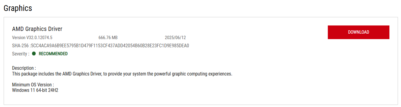

Our website provides the graphics card driver version V32.0.12074.5 for the GZ302EA model.
https://rog.asus.com/laptops/rog-flow/rog-flow-z13-2025/helpdesk_download/
If the installed graphics card driver is not this version, we recommend uninstalling it and then downloading and installing the correct driver from our website to check if the issue improves.
If the problem persists, to rule out system faults, we suggest backing up your data and restoring the system before further verification.
We apologize for any inconvenience caused and appreciate your understanding.

AMD Radeon(TM) 8060S Graphics
Driver Version: 32.0.12079.1014
Driver Date: 8/1/2025
The version that ASUS installed on this machine and delivered to me is a later version than what you referenced.

In my response, I recommended that you install the graphics driver version provided in our official download section, rather than the latest driver from AMD, because the drivers on our website have been fully validated for the specific model to ensure system stability. Based on the issue you described, which has existed since day one of use, I suggest performing a system restore and installing the ASUS official driver to verify whether the problem persists in a controlled and validated environment. We apologize for any inconvenience caused.
