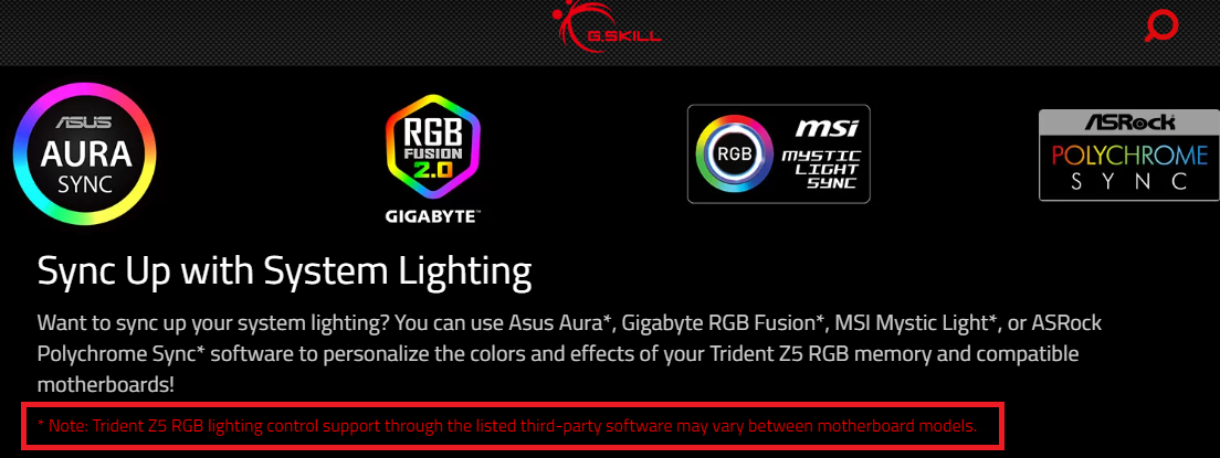

While the F5-6400J4048F24GX2-TZ5RK official website mentions support for AURA SYNC, there is also a note below stating, "Trident Z5 RGB lighting control support through the listed third-party software may vary between motherboard models."
In light of this, we recommend attempting to cross-test with the memory models listed in the QVL.
