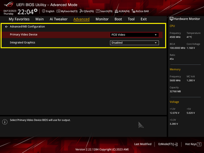

Try setting the following.
13900KS / 8000 CAS36 / ROG APEX Z790 / ROG TUF RTX 4090
