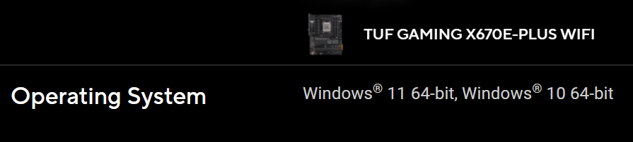

Kindly remove the multi-boot system drive and test the results with only the Windows environment, as the TUF GAMING X670E-PLUS WIFI only supports this specific configuration.

In fact even though you say that the TUF GAMING X670E-PLUS WIFI only support Windows OS, I've rarely encountered any problem running this config on the Linux OS. Anyway, I'll get rid of the dual boot, clean the partitions and boot entries.
I'll then check to see if it solves the problem. However, could you kindly explain why a Linux-based OS is not supported?
