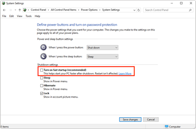

In the meantime, could you kindly check and confirm whether the [Turn on fast startup (recommended)] option under Power Options is unchecked?

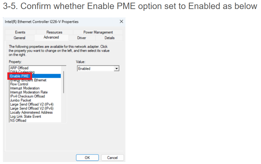

We noticed that in the video you provided, within Device Manager > Intel(R) Ethernet Controller (3) I225-V Properties, the configuration for the “Enable PME” option was not clearly shown.
Could you kindly refer to the relevant guidance and confirm whether your current settings align with the instructions in steps 3-5?

Please try updating to BIOS 3265, clearing CMOS, and then following the steps outlined in the FAQ to ensure that all related settings are properly configured, along with the [Turn on fast startup (recommended)] option under Power Options not being enabled.
