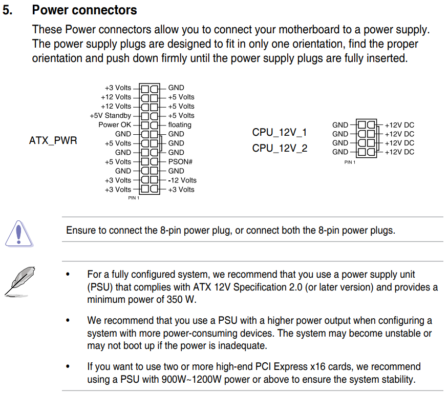

To address this, we recommend not only verifying the hardware installation, including ensuring the CPU is neither loosely nor overly tightened, the thermal paste is adequately applied, and all three power connectors are properly connected.
