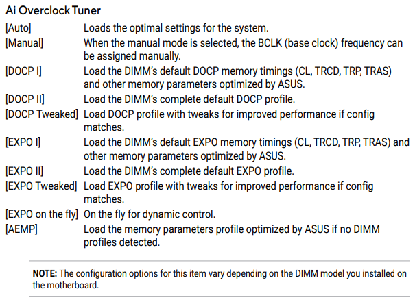

As indicated in the BIOS manual, when applying [EXPO I], it will load the DIMM's default EXPO memory timings (CL, TRCD, TRP, TRAS) and other memory parameters optimized by ASUS. And it appears that the memory module you currently have installed is not listed in the motherboard’s QVL.
Therefore, if you experience instability when applying the default overclocking parameters, we recommend adjusting the overclocking settings according to your usage requirements. If the system is stable after making these adjustments, you may continue to monitor its performance.
