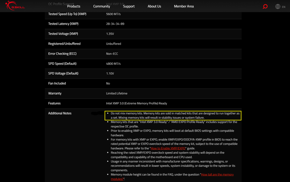

It's not recommended to combine memory kits which it looks like you've done. Remove a memory kit and have the other kit installed in the A2-B2 slots (2nd & 4th slots from the cpu).
With your pc shut down and your memory installed in the A2-B2 slots, press and hold the clear cmos button for 3 seconds, then boot up your pc.

Most (if not all) memory manufacturers will recommend to NOT combine memory kits.

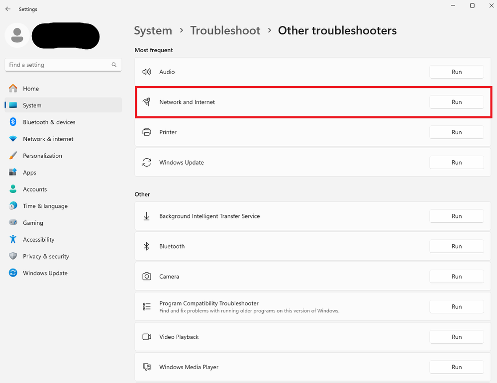

Try running the Network and Internet troubleshooter, it should either fix or identify the issue.
It gives the same results as when I previously ran the troubleshooter. “Troubleshooter couldn’t identify the problem”.
