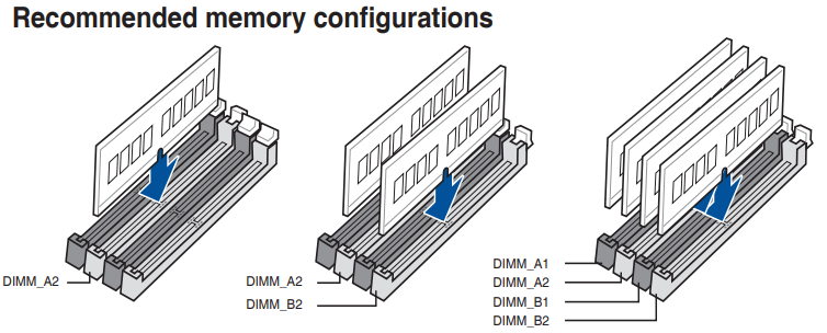

Please install the memory modules in the DIMM_A2 and B2 slots as recommended in the ROG STRIX B650E-F GAMING WIFI user manual.

If needed, you can try installing a single memory module in the DIMM_A2 slot, after successfully overclocking and entering the system, shut down and reinstall the second memory module.
