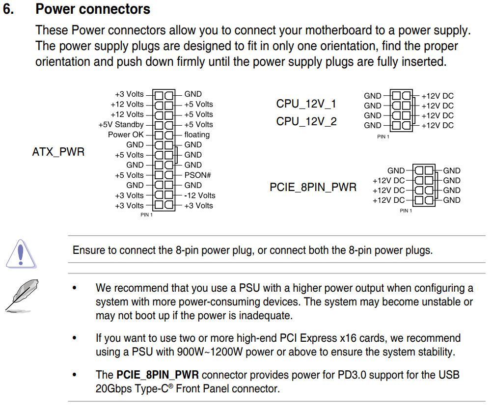

(Q1) Why is the Red LED ON for PLUG_8PIN_PWR when PCIE_8PIN_PWR is connected and manual states "or"?
         The manual states on page "1-10", item 6, "Ensure to connect the 8-pin power plug, or connect both the 8-pin power plugs."
         I assume this statement means connect power to PCIE_8PIN_PWR or both CPU_12V_1 and CPU_12V_2 based on differences
         between ATX power supplies. Please advise if this is incorrect and if all three 12-volt connections are required when using the
         Intel i9-14900k CPU with 1x48GB, 2x48GB, 4x48GB DIMM(s) (model# listed above from Nov 2023 QVL).
Could you tell me if the red LED light refers to the Q-LED of the CPU?
We recommend that you correctly connect the three power connectors: ATC_PWR, CPU_12V_1, and CPU_12V_2. According to the manual, the PCIE_8PIN_PWR connector provides power for PD3.0 support for the USB 20Gbps front panel connector.

The "or" printed in the manual (see text in section 6 of your reply) leads me to believe CPU_12V_1 & CPU_12V_2 were NOT required if PCIE_8PIN_PWR was connected. I'll try all three plugs connected and let you know if this addresses the reported issue.

CPU 1 connection is enough for base 1. Base 2 is required if you want to boost and overclock. But, it can only work with 1, it is simply giving more volts possible to the CPU to push further if necessary.
The PWR is for putting more power into the PCI-E x16 mainly, including if you want to put 2 PCI-E graphics cards, or do extensive overclocking, or have more stability if you have several connections. For example those which are in series 3000 the PWR is clearly not obligatory.
Then, as a second option, the PWR can also be used to fast charge the USB front panel of the tower, but it is still necessary to have USB-C cables connected to the device that supports fast charging. It can be used if, for example, you want to put an external screen connected by USB-C which requires more voltage.
