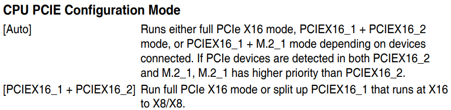

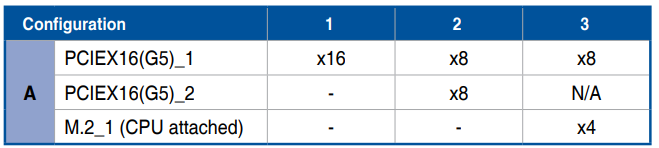

May I confirm if your 5090 GPU is currently installed in the PCIEX16(G5)_1 slot? When you noticed that PCIe 5.0 was not functioning as expected, was the PCIEX16(G5)_2 slot also occupied at the time? Could you try installing the GPU in a different PCIe slot to see if it makes any difference?
Also, have you had a chance to test whether switching the CPU PCIe Configuration Mode in the BIOS to [Auto] or [PCIEX16_1 + PCIEX16_2] changes the result?

Hello ASUS ROG Team,
Thank you for your detailed response and support.
I’ve identified the root cause of the issue: the ALT_PCIE_MODE setting in the BIOS was not set to Auto. After manually disabling it (or setting it to Auto), PCIe 5.0 started working as expected.
Just to clarify:
  • M.2_1 was not in use, so it didn’t contribute to the issue.
  • The GPU is installed in the correct PCIEX16(G5)_1 slot.
  • PCIEX16(G5)_2 was unoccupied during testing.
Everything is now functioning correctly after that BIOS adjustment. Hopefully, this helps others facing similar PCIe detection problems.
