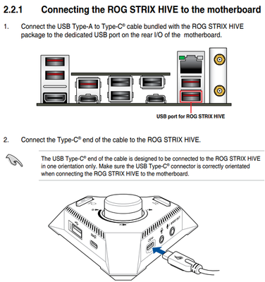

Regarding the ROG Hive Audio, all audio functions on the ROG STRIX X670E-I GAMING WIFI are supported through the ROG STRIX HIVE.
Referencing the installation instructions on the user manual page 2-20, the ROG STRIX HIVE needs to be connected to a specific USB Type-A port on the ROG STRIX X670E-I GAMING WIFI, and the USB Type-C connection to the ROG STRIX HIVE is directional.
We recommend checking if you are using the original connector cable and ensuring the correct connection method before verifying if this resolves the audio issue.
