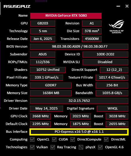

At idle, it seems normal to lower the pcie speed.
My ASUS Prime RTX 5080 shows pcie x16 1.1.

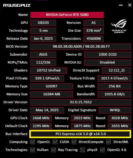

Play a game and it should ramp up to pcie x16 5.0.
