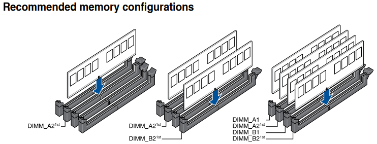

The memory part number "AX5U6400C3232G-DCLARBK" currently installed is not listed in the TUF GAMING B650-PLUS WIFI memory QVL
May I ask if you have tried cross-testing memory from the QVL list?
Is the memory installed in the DIMM_A2 and B2 slots recommended in the user manual, and if only one memory module is installed in A2, does the issue persist?
Could you please provide a complete recording of the problem? This includes documenting the memory installation slots, any RAM error indication lights or possible error prompts when the system fails to restart, and the need to toggle the PSU switch to boot again.
