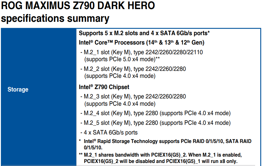

Thank you for reply Jiazzzz_RoG. ROG Z790 Dark Hero has five slots for M.2 SSD. I install 1st T700 SSD, the remain 4 Slot I install Samsung 990 pro SSD 2TB each. In the Bio they all shows up. I will attach picture with this reply. I do not use raid, that why I set My VMD controller set to Disable. In the bio all SATA Enable. In the Samsung Guide Said Must sets SATA Mode Operation to AHCI. But in ROG Z790 Dark Hero Bio I Could not find any AHCI.
My SSD is Currently installed all recognized in the bios.

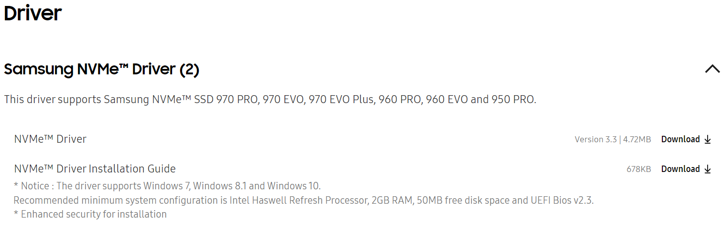

Samsung NVM Express driver 3.3 . This driver supports Samsung NVMe™ SSD 970 PRO, 970 EVO, 970 EVO Plus, 960 PRO, 960 EVO and 950 PRO.
You saw what was printed right in front of us.  We assumed it was a 990 Pro specific support page.
I had just purchased the 990 Pro today and was getting the same 'not connected' for my B650E-F Strix.
Thanks Denny
There are no Samsung drivers for SSD 980Pro and SSD 990Pro.
