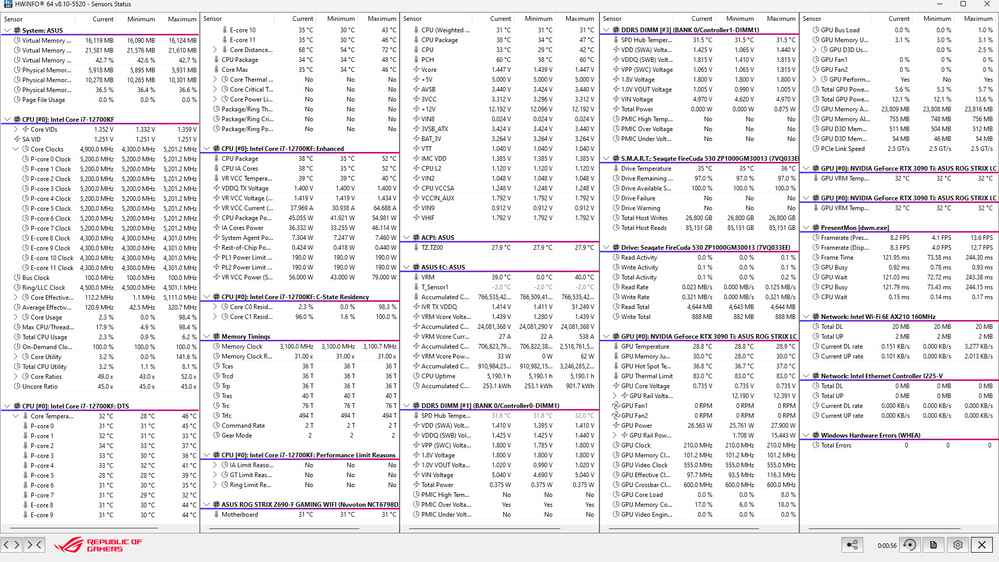

If you can post us a screenshot of HWinfo, this might tell us something. If you install HWinfo, click the Sensors tab, it will show this page below. - HWinfo ROG Edition - HWiNFO Download v8.12 (guru3d.com)
Hi Nate152 Thank you very much for taking this matter into account 1. The RTX 3070 Asus should also work as it has enough speed  I play the game in Teamspeak in 4 VS 4 (random) mode, we are all 4 German players, everyone accesses the server from Germany evenly. And we're connected via Teamspeak. The problem is that I'm the slowest despite the fact that I have everything from Asus. I built the PC specifically so that I don't have these problems, although unfortunately I still have them. My friends always say that I should move more even though I'm moving and I can only see what's happening on the monitor. What's strange is that when I set it to 60 Hz I get 200 FPS according to Nvidea and sometimes it's even more at 120 Hz. What's crazy is the FPS number is so high but I'm still too slow. I don't have any software on the PC to rule it out. The PC has been completely reinstalled without any improvements and I don't run the OC. Maybe it's the graphics card that should be running because I have 2 monitors connected to it. I'm totally at a loss but in the other game we play they also say it, which means it affects 2 games. I feel that something has too little power, too much power or communication is blocked in the bios m e.g. RAM bad CPU defective graphics card is very slow or something like that Maybe in the bios power saving mode if there is something like that
Nate152
Moderator
You're welcome and thank you for the screenshots.

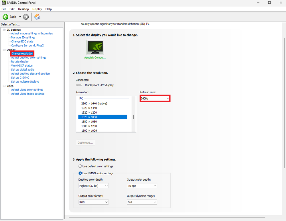

1) Disconnect your other monitor.

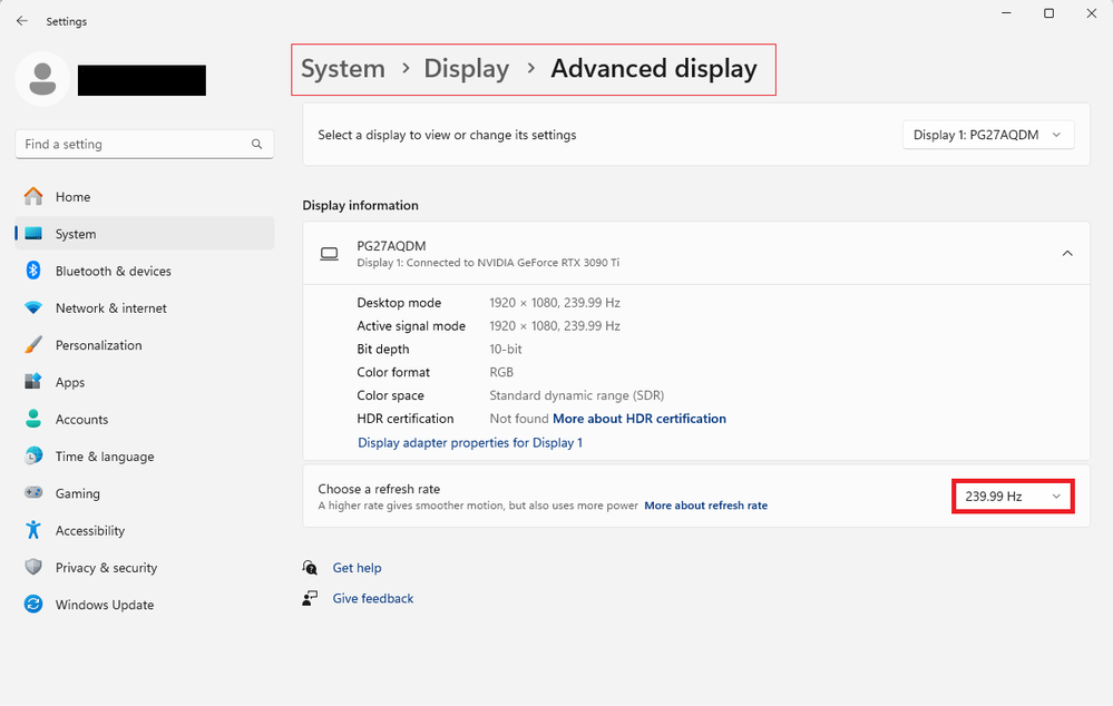

2) Check the refresh rate in Windows and the Nvidia Control Panel are set to 360Hz. I have a 240Hz monitor so this is the highest I'm able to set the refresh rate. Be sure to click Apply in the Nvidia Control Panel.

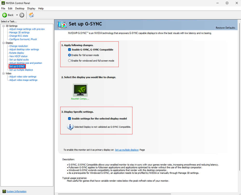

3) Check G-Sync is enabled in the Nvidia Control Panel, be sure to click Apply.

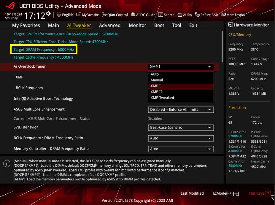

5) Your memory is showing it's running at 4800MHz.  Go into the bios, on the Extreme Tweaker page set the Ai Overclock Tuner to X.M.P. 1, then hit F10 and Enter to Save and Exit. This will bring your memory speed up to 6000MHz.

I have my 12700KF overclocked to an all P-Core 5200MHz, your 5000MHz is normal for default settings.
I forgot to mention:
X.M.P can be hit or miss. After enabling it, your system may or may not be stable. If you have freezing or BSOD's, shut down your pc, press and hold the clear CMOS button for 3 seconds. This will reset the bios to default settings and let you boot up.
So, if you're stable after enabling X.M.P. then all is good. If unstable, manual tuning will be needed to get you stable.
