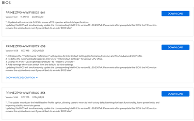

The latest firmware introduced a new option called "Performance Preferences" with the choices "Intel Default Settings" and "ASUS Advanced OC Profile."

But it should be noted that I do not yet have the current UEFI with microcode 0x125, but only the previous UEFI, where Asus introduced the performance preferences.
It is quite possible that the corrected settings for eTVB that were introduced with microcode 0x125 will also apply to you.

That's the point, the settings can't be incorrect. I haven't done anything manually. There are two preset profiles: [Intel Default Settings] and [ASUS Advanced OC Profile]. These profiles are configured by ASUS, and I switch between them, with the profiles changing the corresponding settings. Unless ASUS's [Intel Default Settings] preset are incorrect, but I doubt that's the case.
I hope ASUS responds on whether the default settings in 1402 are essentially the "ASUS Advanced OC Profile" settings for 1661. For now, I've reverted to 1402, where everything was fine without any settings (except "Asus MultiCore Enhancement" set to "Disabled - Enforce All Limits").

We recommend consulting the instructions in "[Motherboard] Intel 13th and 14th Gen K-Series processor stability Improvement with Latest ASUS BIOS..."
If you intend to follow Intel's recommendations, please set the Performance Preferences to "Intel Default Settings."
Are the default settings of version 1402 (essentially any old BIOS without the "Performance Preferences" option) essentially the same as the "ASUS Advanced OC Profile" settings for version 1661 (for the new BIOS with the Performance Preferences option)?
Regarding this inquiry, could you please specify the parameters you need clarification on?
Starting from BIOS version 1656, the introduction of the Intel Baseline Profile option provides Intel's factory default settings aimed at basic functionality, lower power limits, and improved stability in certain games, which were not available in previous BIOS versions.
