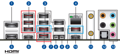

I got a B650E-E system set up in December, and noticed that some of my USB devices weren't working. Normal troubleshooting, I just unplug and replug somewhere else - worked - good to go, moving on.
But lately, as I've added more devices occasionally or moved things around, that certain USB ports just will not work regardless of the device I plug in. I'm on the latest chipset drivers, BIOS is on the 11/18 release, but the USB 3.2 Gen 2 Type-A ports labelled E1, E2, and 3 (Also, why this naming pattern?!?) all do not work. Haven't had the chance to confirm if the USB-C in the same column has the same issue. (If you're looking at the B650e-e's manual - this is page 2-22, and is the first column of USB ports after the HDMI and DP ports)
The USB controller for these ports is installed and not reporting issues, and all USB ports with these labels are listed and marked active in the BIOS.

Circumstances/Frequency: Literally nothing happens when any usb device is plugged into the following ports:

Regarding the USB 3.2 Gen 2 Type-A ports, there are a total of 6 ports for code 2.
While you mentioned an issue with the area marked by a red box, we would like to confirm if the area marked by a blue box is also experiencing the same problem.
In order to gather more detailed information and further consult with the relevant departments, may I ask what brand and model of device you used to test the USB 3.2 Gen 2 Type-A ports?

Tried this just now, no effect. The same ports in the image I posted above are not responding.

Yes, I did the BIOS 1616 last night. Things are stable, but the same USB ports are still not working.
