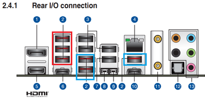

I got a B650E-E system set up in December, and noticed that some of my USB devices weren't working. Normal troubleshooting, I just unplug and replug somewhere else - worked - good to go, moving on.
But lately, as I've added more devices occasionally or moved things around, that certain USB ports just will not work regardless of the device I plug in. I'm on the latest chipset drivers, BIOS is on the 11/18 release, but the USB 3.2 Gen 2 Type-A ports labelled E1, E2, and 3 (Also, why this naming pattern?!?) all do not work. Haven't had the chance to confirm if the USB-C in the same column has the same issue. (If you're looking at the B650e-e's manual - this is page 2-22, and is the first column of USB ports after the HDMI and DP ports)
The USB controller for these ports is installed and not reporting issues, and all USB ports with these labels are listed and marked active in the BIOS.

According to your description, you have tested the port located within the red box below.
Have you tried cross-testing it with the port marked within the blue box?
Please refer to How to clear CMOS? and clear the CMOS first.

I'm going to info dump since I'm a little late to the party here. I've been facing this same issue since I built my system a few weeks ago. Bios 1413 did not fix the problem for me. Similar to others, the ports affected are E1, E2, E3, and 3.

Just wanted to chime in and say I'm having this exact same issue. Bought the Strix B650E-E, top 3 USB ports (red box in the picture above) do not work, along with one on the row below. BIOS version 1413, then later 1414, no effect, still broken. Later, I had to RMA the board because of another issue, and I'm sad to say my replacement board, while otherwise fine, has the exact same problem. Some serious issues with USB quality control here, guys. Guess I'll just wait for another BIOS update.
