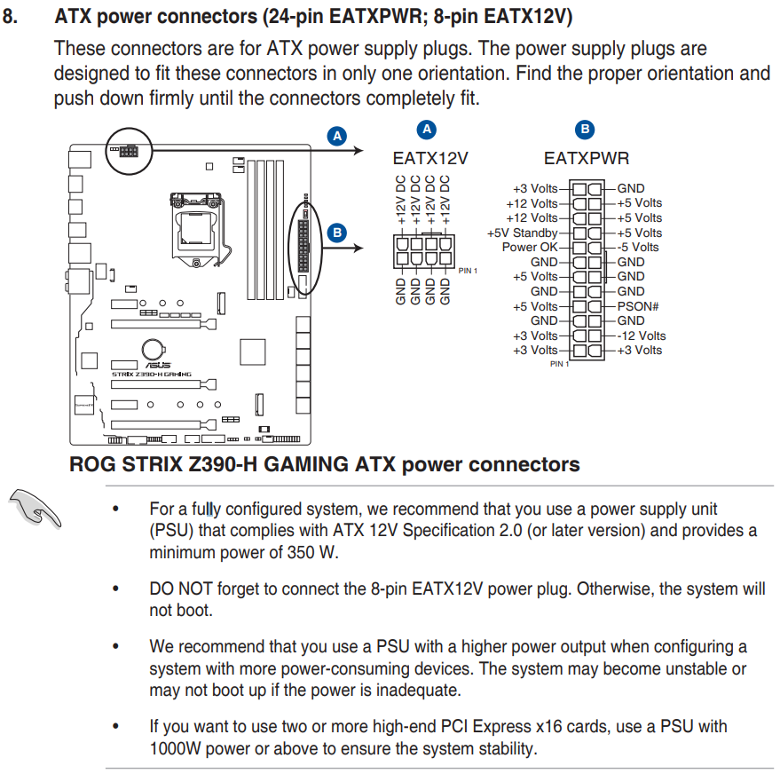

Could you please share the brands and models of the PSUs you have tested? Have you used the power connector that came with the PSU to connect to the motherboard?
Could you also provide a photo of the connection?
According to the ROG STRIX Z390-H GAMING User’s Manual ( English ), both ATX power supply plugs labeled as A and B need to be correctly connected.
We recommend cross-testing with different power connectors and double-checking the power supply connection.
Thank you.
