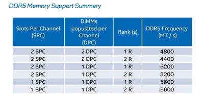

Apologies for the late reply (seeing as you've already added multiple updates), but combining and mixing memory kits isn't supported by memory or motherboard vendors. This is because memory vendors bin and validate the memory kit in the density in which it is sold. If you combine memory kits the settings in which the kit is validated for XMP are no longer valid. You would need to return one or both of the memory kits and purchase a single kit validated for the density and frequency you are trying to run.
See Intel's chart for DDR5 memory support on Raptorlake. Please note that frequency beyond what is noted here is considered an overclock depending on the configuration as outlined.

No problem. It's a widespread misconception—the higher the density and the faster the frequency the less chance there is of success. Memory vendors don't account for users putting these kits together, there's no end of the possibilities when trying to account for this. That's why it's simpler to stipulate that they are only validated as a single kit, because that is the reality.

Yep. High density kits at higher frequency can often be quite hard on the CPU memory controller anyway. Adding another kit reduces our chances even further, and some users simply don’t understand why.
The memory vendors don’t account for users doing this, and quite often with DDR5 you won’t find [single] kits validated or sold for the frequency and density you are trying to run because the platform isn’t capable of running them at that speed unconditionally or even at all.
