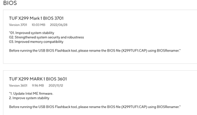

The latest BIOS version for the TUF X299 MARK 1 is 3701, released on June 28, 2022, and requires manual download and update.

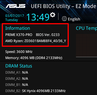

Also, according to the official website of the TUF X299 MARK 1, there is no version 2.17.1246 available.
It is recommended that you enter the BIOS to confirm the current version.
If necessary, please provide a screenshot of the BIOS main page.

Based on the image you provided, there is no information displayed regarding the BIOS version.
It appears that "version 2.17.1246" is not the BIOS version.
Please refer to How to check your BIOS version, enter the BIOS and check the current BIOS version on the main page.
