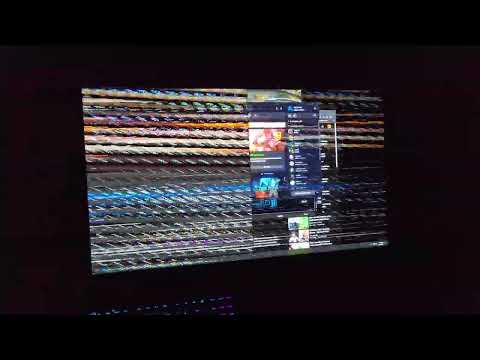

Hello all I've recently bought the Asus PG27AQDM OLED monitor and have been blown away with it. I did find an issue after using for about 2 weeks now. Randomly while in HDR I found that my screen signal starting showing scan lines and artifacting, also the middle of the screen was split in half where the left side had more issues than the other side. It looks something similar to example below.
Example: https://v.redd.it/fx0tkn536fj81
Initially I shut off the monitor, unplugged the display port and restarted my machine, this did not solve the issue. Fortunately I did find a solution where I had to completely unplug the power cable from  the monitor and plug it back in, this fixed this issue and returned the monitor to normal. My monitor power supply cable is connected to a UPS so there isn't any grounding issues. The display port is v1.4 and is brand new as I purchased it before getting the monitor so I don't suspect any insolation, interference or cable issues.
I am wondering if I this is a common issue or is it possible that my monitor is already beginning to have issues?

- Could you please clarify what you mean by "flickering"?
Here you are in video as happend at MANY other custoners - soon or LATER! https://www.youtube.com/watch?v=lKFUcGSOCAY
- It would be helpful to provide a complete video recording of the issue, including any troubleshooting steps you've attempted and their results, to help us better understand the problem you're facing.
Nothing special: Turned on the computer, surfed for an hour so I was playing League of Legends and when I used the ALT-TAB the KNOWN PROBLEM occurred which Asus can refer to on the Reddit threads: https://www.reddit.com /r/OLED_Gaming/comments/135lf3u/asus_pg27aqdm_issues_thread/?utm_source=share&utm_medium=ios_app&utm_name=ioscss&utm_content=2&utm_term=1

Canaan
Level 9
I can confirm that the issue is still there on the MCM104 version. I got it a few days ago when switching from HDMI-1 to DisplayPort.
It's still very rare (it only happened twice since I have the AQDM), but someone who often switches video output or does a lot of alt-tabbing when playing full screen will eventually notice it.
https://i.imgur.com/BHcMl8R.jpg
The only known workaround is ​​to unplug and replug the power cable.
