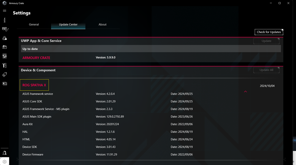

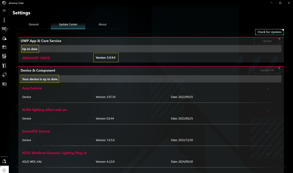

If you've reset the firmware, install Armoury Crate and check for an update at the update center.
Armoury Crate version 3.2.11.2 - Armoury Crate - Support
It should update to 5.9.9.0.
You will need to have the charging dock connected and working to do the update in Armoury Crate. When using wired mode, the dock won't light up. When using 2.4GHz wireless mode, the dock should light up.
1) Make sure the charging dock is connected to a pc usb port and it's powered on and working.
2) Grab the other cable from the Spatha X box, connect it to the Spatha X and a pc usb port.
3) Set the wireless switch on the bottom of the mouse to wired mode.
4) Try the update in Armoury crate.

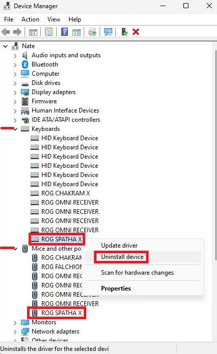

You can try uninstalling your ROG Spatha X from Device Manager, then reboot.
Under "Keyboards" and "Mice and other pointing devices", right click and uninstall. You can uninstall all HID Keyboard Device for good measure.
Does this get your ROG Spatha X working properly?
