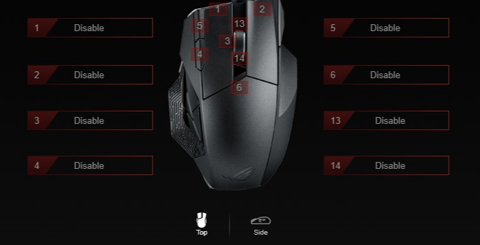

It also starts going crazy in the settings in armoury when that happens like for example all buttons changed to disable, dpi goes 8200 or 50 (bugged, it wont really move), color gets set something completely different than what i set but usually goes white on its own, and i need to reset all settings to default.
