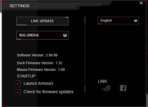

I updated the firmware of Spatha and now is not working in wireless mode. I tried updating the dock, the armoury. I tried to unplug the battery, reinstall several times armoury and still not working....Is like the dock and the mouse can´t pairing
Armoury version: 2.04.09
Firmware: 1.69
Im sure 100% that is a software problem.
Any ideas?
Thank you in advance

So wireless was working previously? Did this happen after upgrading to Armoury 2.04.09?
Is your dock firmware on 1.32?
Are you on the latest version/build of Windows 10?
Is the dock connected to a hub or a laptop? Tried different USB ports?

MasterC@ASUS wrote:
So wireless was working previously? Yes
Did this happen after upgrading to Armoury 2.04.09? Yes
Is your dock firmware on 1.32? Yes
Are you on the latest version/build of Windows 10? Yes
Is connected to a hub, then I tried to connect directly to the laptop, tried on pc, tried on mac....
