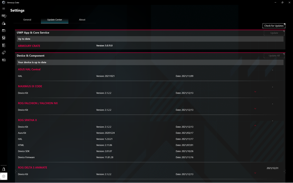

I was using the ROG Chakram Core and am currently using the ROG Spatha X and haven't had any problems.
Here is a screenshot of my update center in Armoury Crate.
Click the pic to make it bigger.
