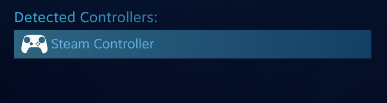

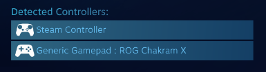

When Joystick Compatibility Mode is on (function is exclusive to Chakram X only, not the Chakram), the mouse is not detected as a controller. Despite not detected in Steam as a controller, do those games you mentioned still see the mouse as a controller? How about if you add the EA/Origin launcher into Steam and start the game that way?
For the dozens of games we've tested, none of them has this problem. Unfortunately, we did not have those games you mentioned.
If Joystick Compatibility Mode is disabled, then it should be detected and indicated as below:

Strange.
Joystick Compatibility Mode wasn't doing anything at first, but after reinitialising all my profiles and activating it once again, it did disconnect and reconnect the mouse and the Chakram X input dissapeared from the controller list on Steam just like your screenshot. I did some tests on games that seems to have problem right after, and they all worked fine, Chakram X was not detected as a controller in those games, even FIFA 23 without adding Origin to Steam... So I guess all of my trouble was a profile issue?
