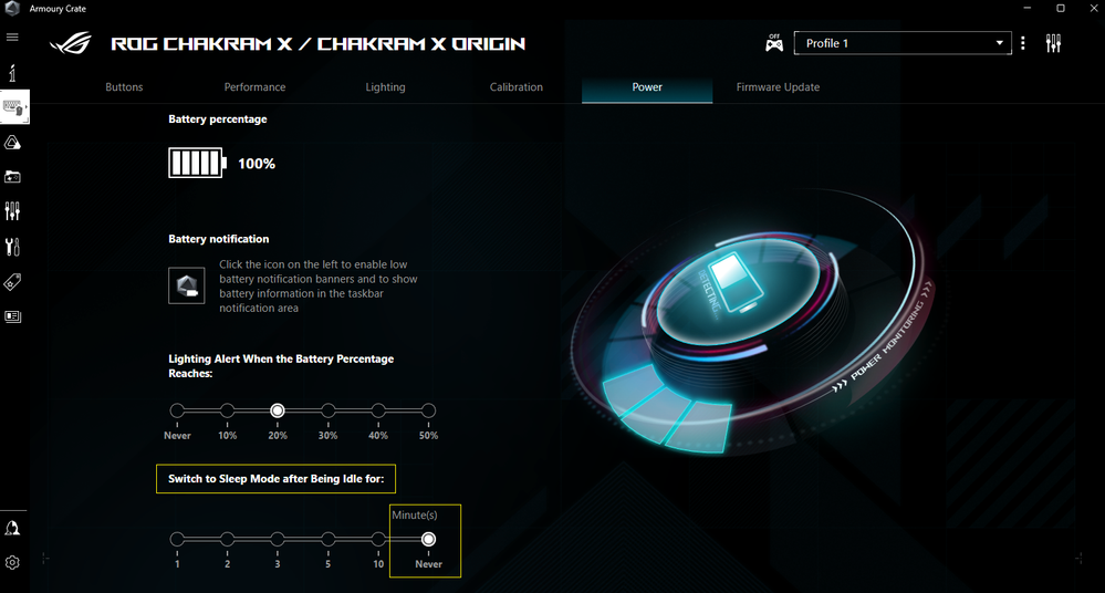

Are you sure your ROG Chakram X isn't going to sleep?
On the Power tab, try setting the sleep timer to Never.
It's set to 3 minutes and it happens when I'm actively using the mouse, I don't think I notice a flash in the LEDs, will try it and report back.
