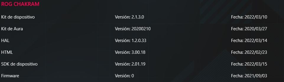

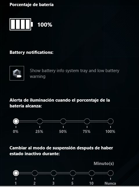

I have the latest updates and this configuration, in case you have the same, to factory reset you have to press left click + click wheel + right click for 10 seconds, then hold down connecting the cable, but with the switch to the center, release with the cable connected and ready your mouse will be factory and update and tests 😛
92485
config
92486

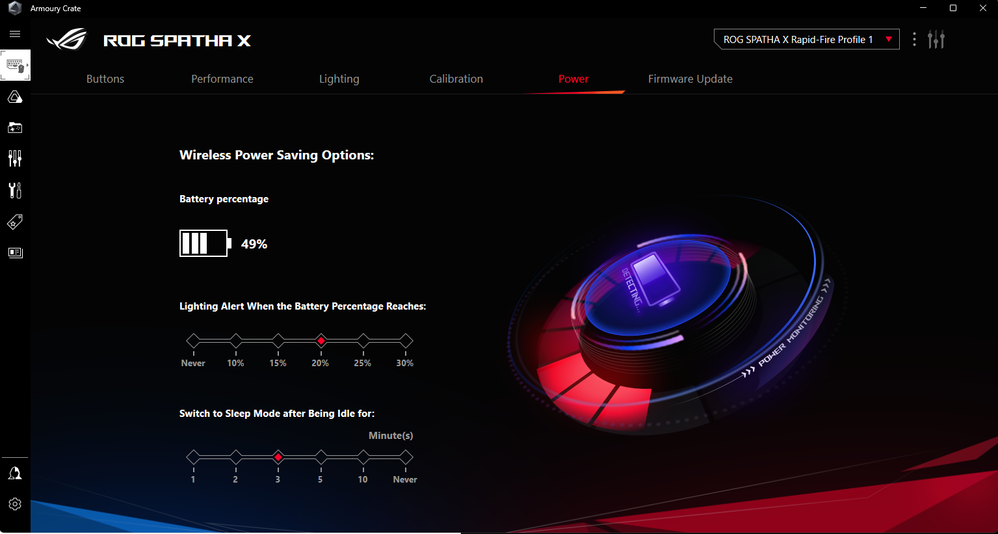

Let me know how it goes, I'm using the ROG Spatha X and sleep mode is working ok.
92511
