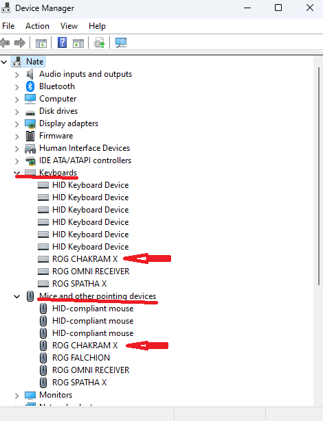

If this doesn't work, open device manager. There will be two ROG Chakram X's, right click on both and click uninstall. Reboot and check Armoury Crate for updates.

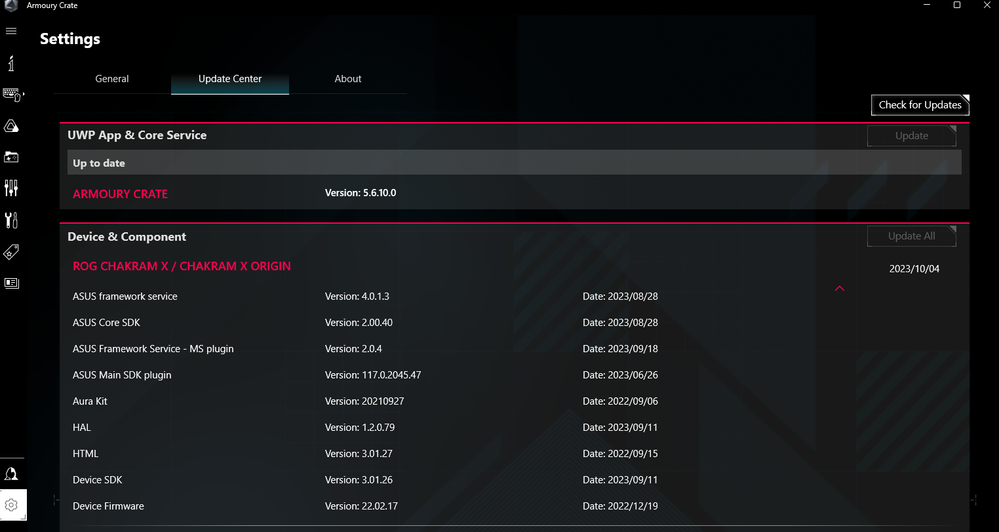

Here are the latest versions to compare.
I tried to do both of those things but none helped. I also have the same version as you do. 
