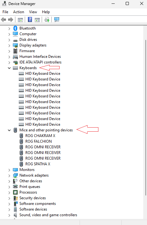

Since you're unable to do this, try uninstalling them from device manager.
Connect the cable to your ROG Keris and your pc, let the wireless dongle connected to your pc.
Then, in device manager under Keyboards and Mice and other pointing devices, right click and uninstall all ROG Keris you see and reboot.
After doing this, try pairing again.
